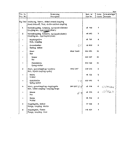

I am looking for information and pump that could run straight on a D/DS10 D/DS11 engine. Any suggestions ?

On the drawing you have, is there a Scania part number on it???
May be i can help you, i have to look in our basement if there is any thing on power take off on ds10 motors.

It is on the pdf you can download from the link under the picture ;) All the part numbers. I would really like to have those.

Hej Philippe!
I have found some pages to you regarding front mounted powertake off, the one on your page is no longer in stock at Scania, but may bee you can bee lucky that they have it by GKN, if not you have to make it as on newer truck as on L-LB 81 and 111.
But then you have to get made an flange as on the last drawing, and i recomande that you use Spicer 1300 shaft, and mount the flange on the motor with longere bolts with strength 10.8 or 12.9, and i also recomande you to change the bolt in the cranckshaft to Scania 279335.
Best luck
Finn L. Holm

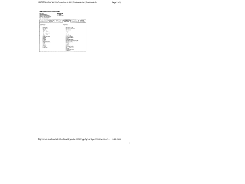

Hej Again Philippe
Here is the rest of the pages.

Thank you for the information, but it seems I cannot read the text as it is too small, even if I click or download the pictures themself.
What, where and how to reach GKN ?
I am starting to order the parts I can get and maybe machine the parts I am missing.
