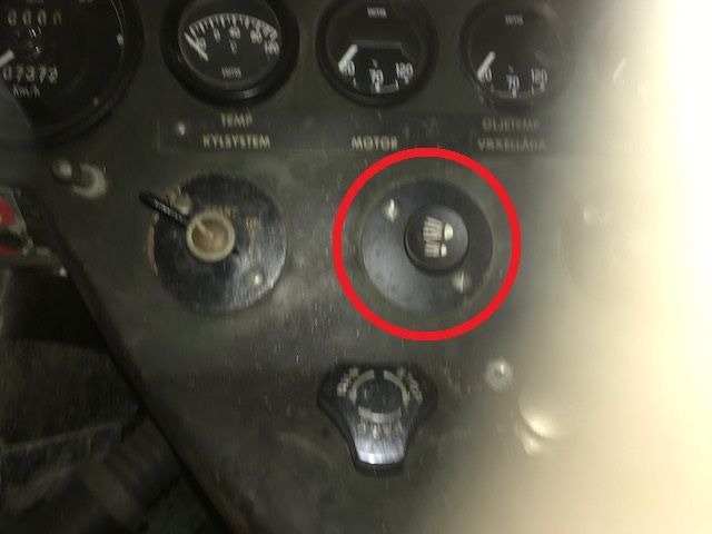

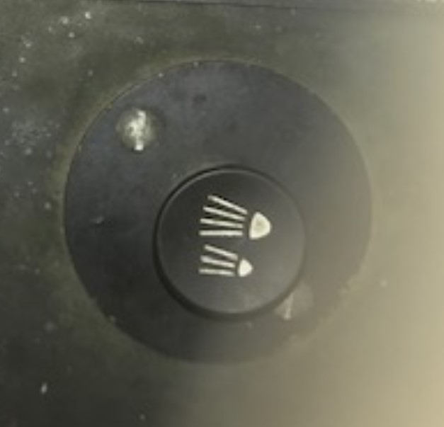

Hi all,
I'm wondering if this light switch is a standard military vehicle light switch in Sweden?
Also, is it a push switch, or does it turn?
It's fitted in the Amfibiebil 101, but is not the standard Alvis equipment.
Many thanks
Light switch 3.jpg (77.71 KiB) Visad 9880 gånger
Light switch 2.jpg (119.43 KiB) Visad 9880 gånger

Definitely not a Swedish standard military vehicle light switch.
/baklastaren

I think its an old volvo light swich model 140 from 1967. U pull and first stop i parkinglight and all the way out lights.

Correct, it's the middle one in this auction; https://www.tradera.com/item/1000970/62 ... rombrytare
Pull out switch for headlights, early Volvo 140 series.
