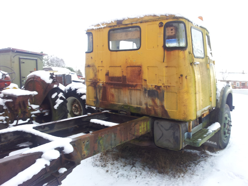

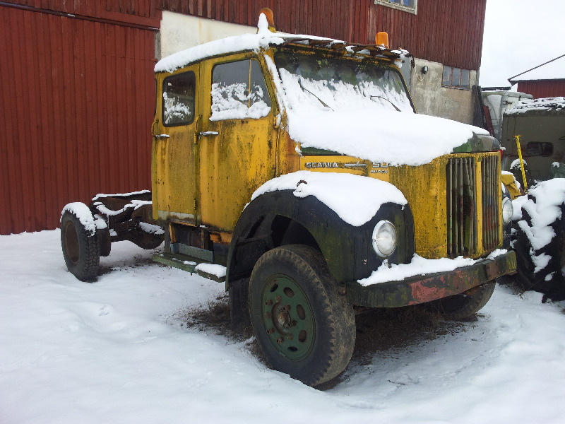

This truck (an L50) was standing nearby my neighbourhood a year ago.
I guess the truck was meant to be scrapped.
Even though it is a crew cab it seems that the back of the cabin is the same as on "normal" cabs.
I can check if the truck still exists. The owner is not easy to get in touch with since he is living a bit distant from the workshop, but I can try to find him and ask if he is willing to sell a few of the windows.
