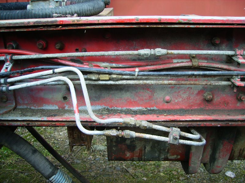

all air lines sanded and sprayed .
there are many.
