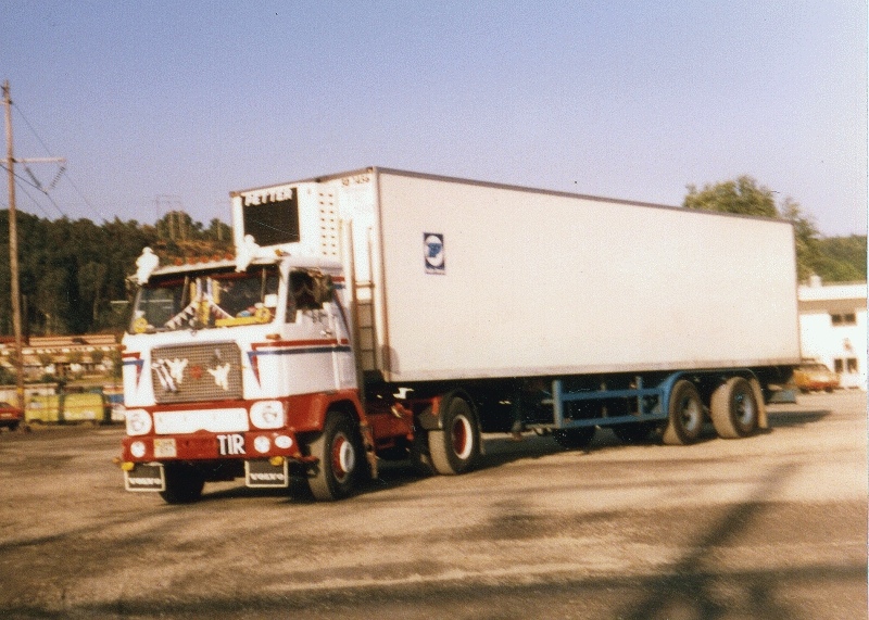

VOLVO L49513 Titan TIP TOP -65
AHW 191 Chassinummer 892
Dragbilsbyggnation ALPUS
Med tillhörande 10 m RoRo trailer under uppbyggnad i TIR utförande för trafik mellan England - Norden

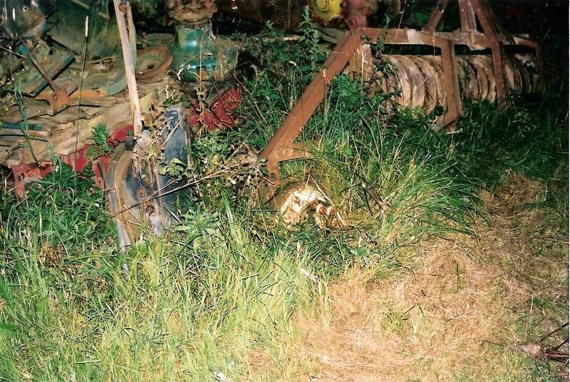

BERTIL NICANDER MARSTRAND KÖPTE BILEN NY, DEN DÖPTES TILL LEOPOLD 15 NOV 1965 PÅ VOLVO KUNGÄLV SOM FLAKBIL, DEN STOD SOM DRAGBILSCHASSI OCH GJORDES OM TILL FLAKBIL MED 4,90 HJULBAS SOM VAR DEN ANDRA KOMBINATIONEN PÅ AXELAVSTÅND, BERTIL KÖRDE ÅT ASG PÅ FINLAND UNDER 5 ÅR MED BILEN INNAN DEN BYTTES IN PÅ SCANIA, BILEN KÖPTES AV HILMER HELANDER GÖTEBORG, SEN KENNETH JOHANSSON OCH GJORDES OM TILL DRAGBIL IGEN OCH HAMNADE PÅ BIL & TRUCK GÖTEBORG 1971, DÄR KÖPTES DEN AV ÅKARE GUNNAR SUNDQVIST SOM KÖRDE ÅT AUTOTRANSIT, BILEN GJORDES OM TILL TRAKTOR 1971 FÖR ATT BLI TERMINALTRAKTOR PÅ PAPYRUS KOPPARFORS BRUK I FORS, SENARE ÄVEN TÄNDSTICKSFABRIKEN TIDAHOLM, HAMNADE PÅ AUTOTRANSITS TERMINAL I SKANDIAHAMNEN DÄR JAG (ROBERT) KÖPTE DEN FÖR 3000 KR OCH 14 ÅR GAMMAL, SKULLE JU BLI EN RIKTIGT TUFF A-TRAKTOR DRAGARE VILKET BLEV DEN FÖRSTA RENOVERINGEN FÖR MIN DEL AV DENNA BIL, SÅLDE DEN 1986 OCH DEN FICK EN TUR RUNT VÄNERN INNAN DEN HAMNADE HOS LENNART OLOFSSON I SALEBY UTANFÖR LIDKÖPING, SOM SKROTADE NER DEN OCH LÄT DEN LIGGA UTSPRIDD PÅ ÅKERN UNDER 8 ÅR INNAN VI LYCKADES HITTA DEN IGEN, VI SÅG NOG INTE MED KLARA ÖGON NÄR VI BELUTADE ATT RENOVERA UPP DEN IGEN OCH FINNA ALLA DE DELAR SOM LÅG UTSPRIDDA, INTE BARA I SALEBY, JAG OCH RUSTAN HAR LAGT NER ENORM TID PÅ ATT ÅKA RUNT OCH LETA DELAR ÖVER LANDET OCH ÄVEN I NORGE, VI HAR SATT IHOP BILEN SJÄLVA EFTER LACKERING, TILLVERKAT INREDNINGEN, DRAGIT ELSYSTEM, MEN HAFT HJÄLP MED RAMEN OCH DRIVLINAN INNAN LACK AV GRANQVISTS LASTBILSERVICE GÖTEBORG

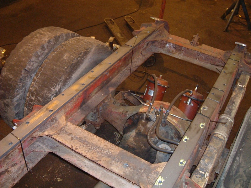

Bakdel ram

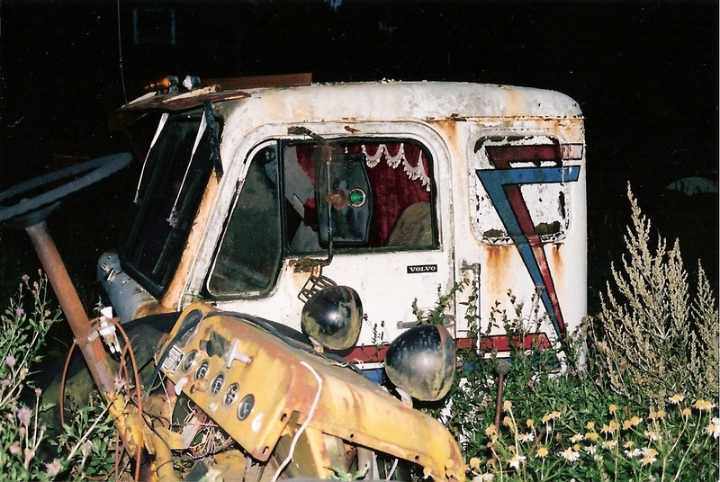

Framdel ram DEN SOM SÖKER FINNER.. MEN VEM KAN TRO ATT DETTA ÄR EN TITAN, DOCK I DELAR DÅ MAN 1996 INSETT ATT DET INTE ÄR EN F 88:a OCH DÅ OINTRESSANT FÖR OMVÄRLDEN........TRODDE DOM JA
NERMONTERAD OCH SKROTAD I SALEBY/LIDKÖPING Hytt funnen

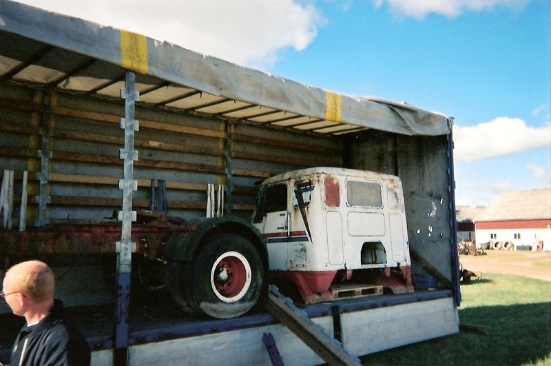

Fynden lastade på trailern för hemfärd till Mölndal

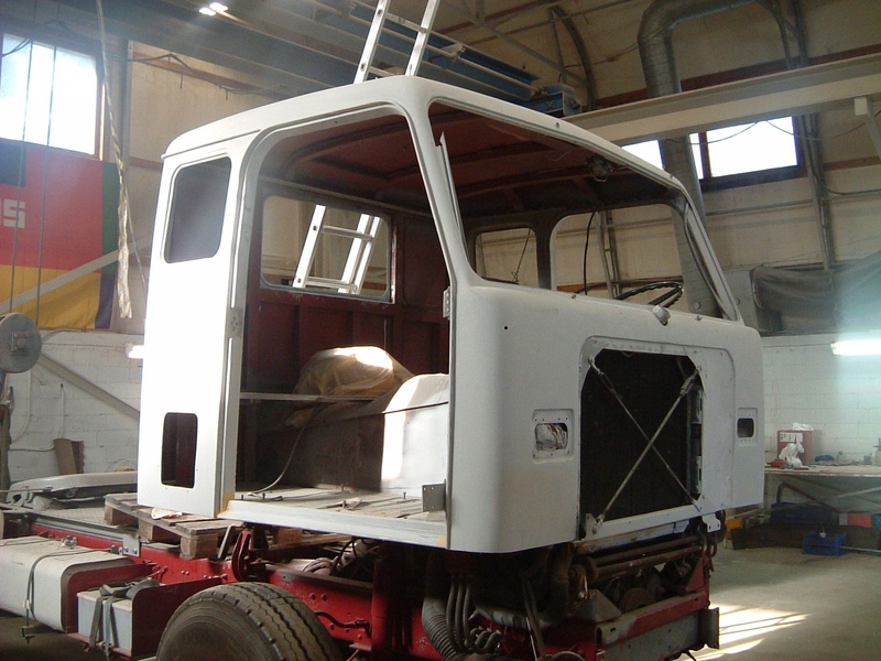

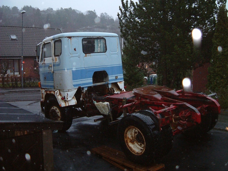

DÅ VI BESIKTIGAT ALLA DELAR OCH BÖRJAT IHOPSÄTTANDET INSÅG VI ATT ANNAN HYTT KRÄVDES, VI LYCKADES HITTA EN ANNAN TITANHYTT SOM VAR LITE FRISKARE OCH ETT BRA ÄMNE ATT GÅ PÅ...HÄR MONTERAD PÅ CHASSIT..

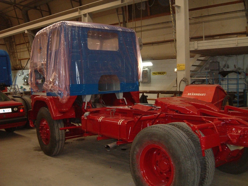

MYCKET RAMARBETE, DRAGBILSBYGGNATIONEN ÄR NU AVMONTERAD OCH JÄRNEN ÄR BORTA OCH NYA UTMÄTTA INNAN BLÄSTRING FÖR ZINKNING

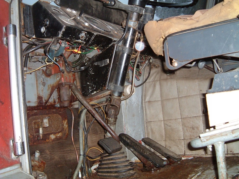

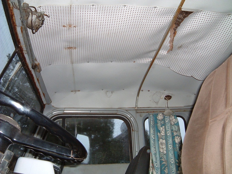

SÅ HÄR SÅG DELAR AV INREDNINGEN UT 2004, TAKET VAR FRÄSCHAST MEN FÖLL ISÄR TROTS FÖRSIKTIG NEDMONTERING
UT MED ALLT GAMMALT

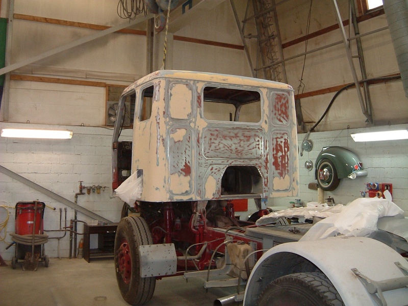

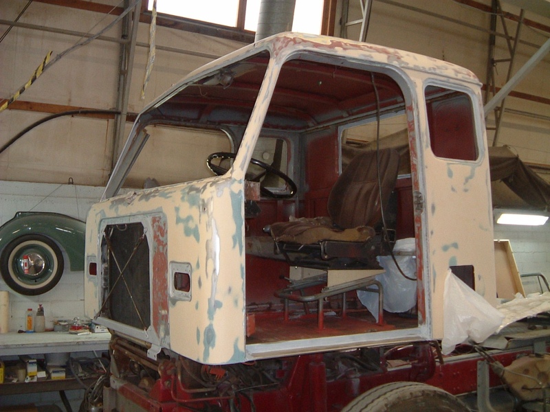

DET SKALL BLI 300 TIMMARS SVETS I HYTT, EN 3:E HYTT KRÄVDES FÖR ATT FÅ TILL PLÅTDELAR TILL BRÖSTET SOM VISAR SIG VARA LITE KROCKSKADAD BAKOM PLÅTEN, RIKTNING AV A- STOLPAR, NYA RUTRAMAR SOM ROSTAT BORT FULLSTÄNDIGT, OBEFINTLIGA TRÖSKLAR m.m m.m.
HELA SVETSAR HANDLAR DET OM , SAMT NY PLÅT I BÄSTA KVALITE, HALVA MOTORTUNNELN BYTS UT FRÅN EN ANNAN HYTT OCH NYA TRÖSKLAR GÖRS I 3 DELAR FÖR ATT FÅ RÄTTA RADIEN OCH UTSEENDET
RIKTNING OCH NEDSLIPNING  EFTER ALL SVETSNING
EN  BRA GRUND ÄR FÖRUTSÄTTNING FÖR BÄSTA RESULTAT
NU ÄR HYTTEN KLAR OCH SLIPGRUNDAD OCH SKALL IN I BOXEN FÖR LACKERING

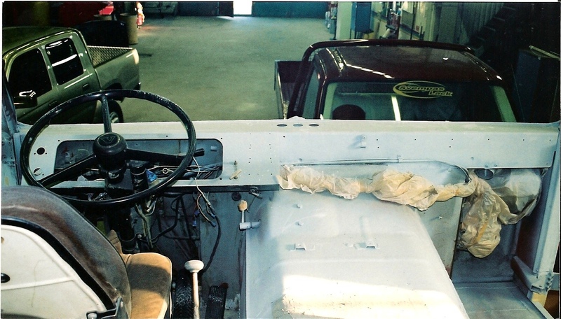

INSTRUMENTBRÄDAN RENSAD OCH HYTT GRUNDMÅLAD , VIT RATT SKALL IN DÅ ALLA VÅRA VOLVO HADE VIT RATT EFTERSOM SCANIA LEVERERADE DETTA (PAPPAS IDEÉR) VAR LITE STATUS MED DETTA PÅ UTLANDET

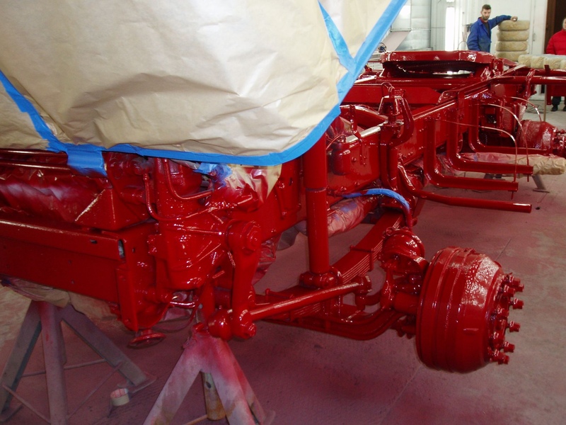

NU FÅR RAMEN SIN SLUTLIGA RÖDA KULÖR ÖVERALLT

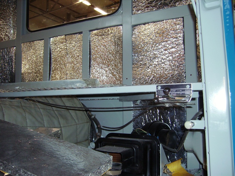

MONTERING AV LJUDISOLERING FÖR ATT KUNNA PRATA I SAMTALSTON I HYTTEN UNDER FÄRD...

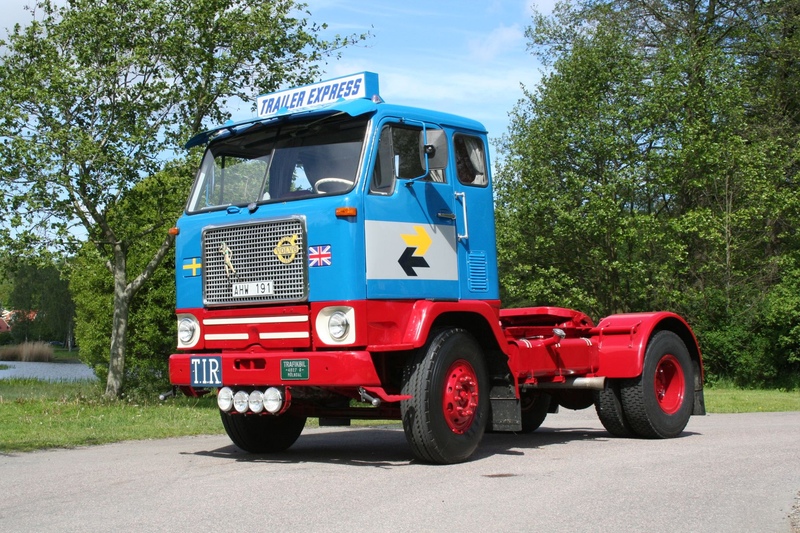

VI ÄR OTROLIGT STOLTA ÖVER RESULTATET AV DETTA OVANLIGA EXEMPLAR SOM ENDAST GJORDES I 953 ex 4X2 OCH 476 ex 6X2, DET VAR JU INGEN BRA BIL EGENTLIGEN SOM HADE MÅNGA SVORDOMAR PGA NO-SPIN IHOP MED SERVOSTYRNINGEN, KOKANDE MOTORER OCH SJUNKNA FODER SOM VAR L

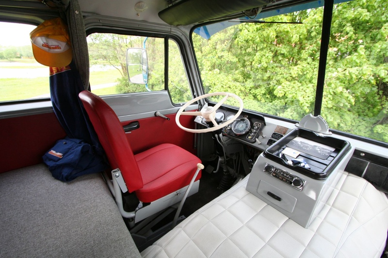

INREDNINGEN 2007 BLIR RIKTIGT LYCKAT, VI HADE TEX TUREN ATT FINNA HELT NYA STOLSDYNOR AV ORIGINALUTFÖRANDE I NORGE TILL BÅDA STOLARNA..
